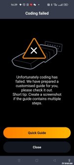

my car is 06 bmw e85 3.0I n52
I want code something,it can obd2 connect, show live data, but when i push code button,it show code fail.
Have any idea?thanks. :(

Ignition on during the coding? I have the same car and also use Carly.
The only issue I had was that Carly for some reason had de-activated my subscription, so had to email them to get it activated again. That also caused me not to be able to reset any faults.
