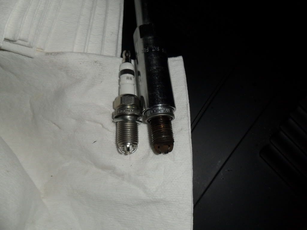

Right well after close inspection all is well, after which I ran the fuel tank down as low as possible then filled the tank to full, now the smoke has much reduced..! also gave her a full service. She had one 1500 miles ago at BMW but only an oil service, was surprised at how dirty the plugs were:-

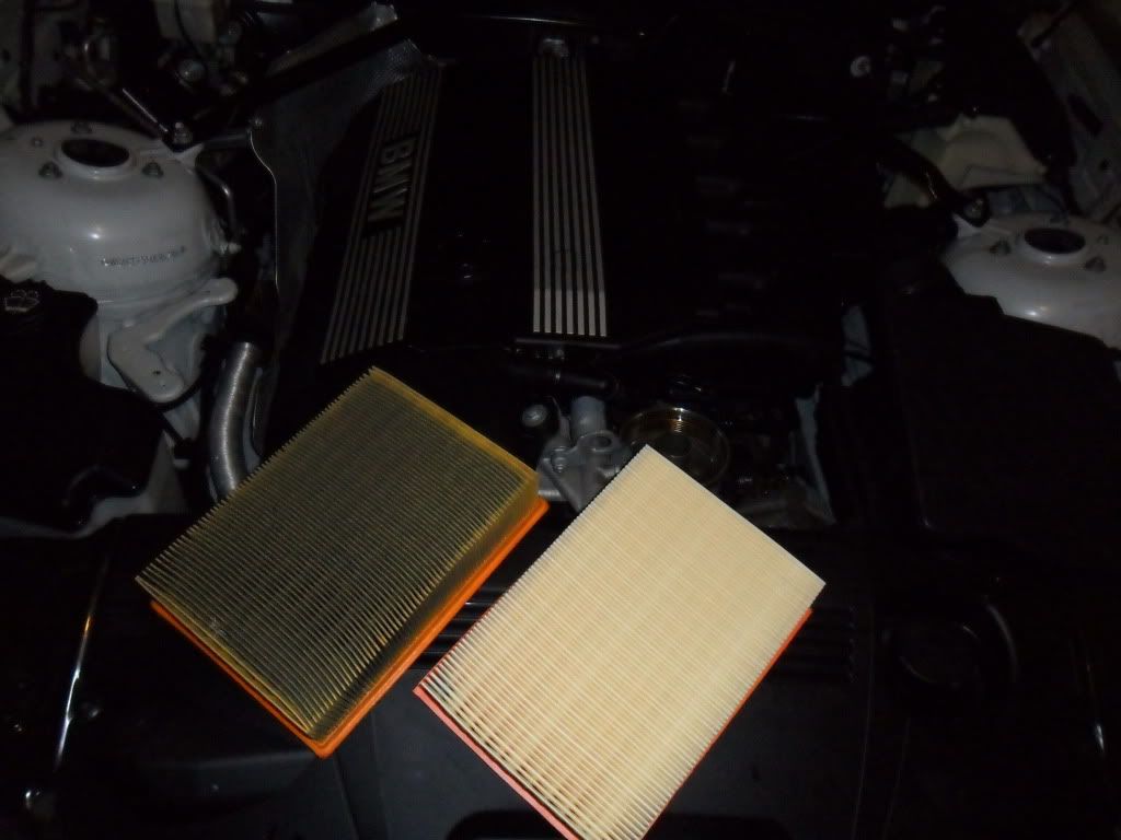

And the air filter:-
But now runs very well.!

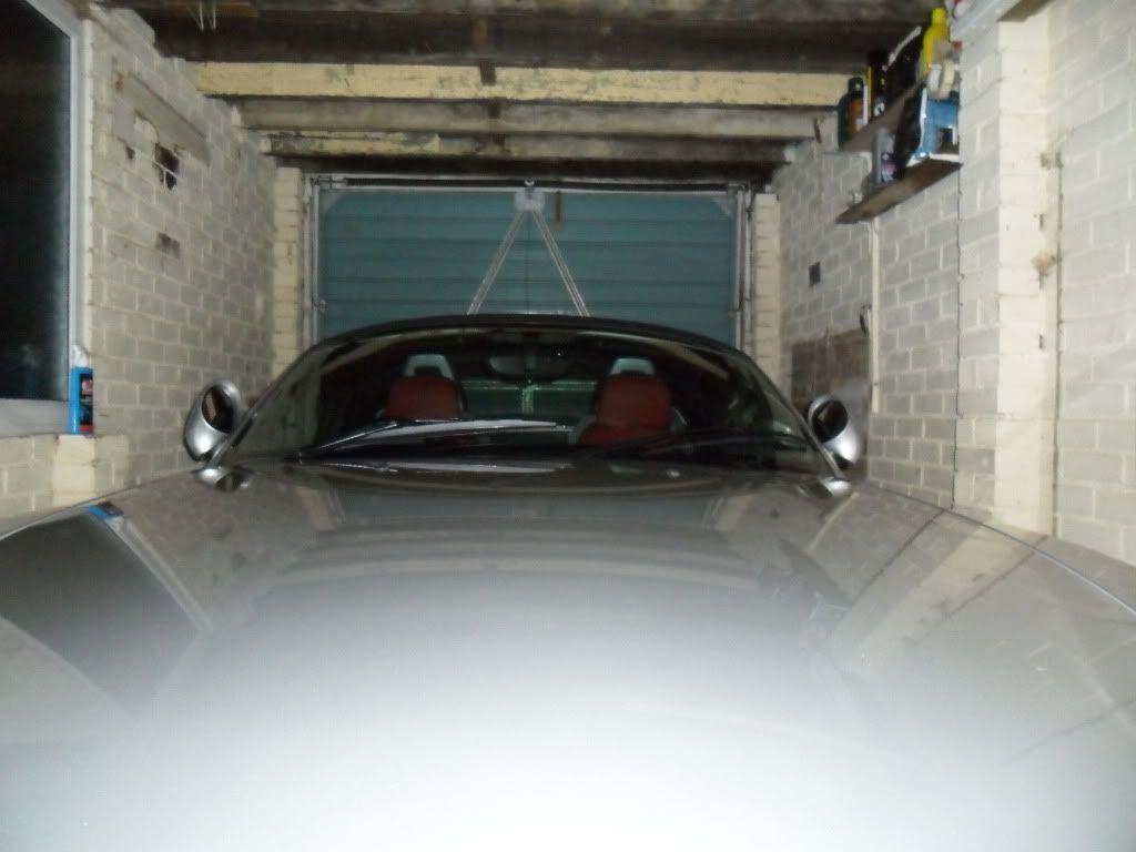

One last pic all tucked up for the night, sorry for the poor quality (and my old garage) but I go to work in the dark and come home in the dark 7 days a week at the moment :(

Anyway, Tim, you didn't say how many miles on the car but those plugs don't look normal. I checked mine at 90K miles with the whole intent of replacing them but they looked literally brand new. Hard to tell from the picture but it appears like rust on the plug tips and that may explain the coolant loss and the white smoke. No matter what the mechanic says, a healthy motor should not generate any smoke, while, black, gray/blue or otherwise when warmed up at idle. If it were me, I would ask the shop to do a cooling system pressure test to rule out internal coolant leak.

The car has done 51k and though the plugs are dirty they are not showing anything wrong (apart from poor maintenance by previous owner) if the engine was using water in a cylinder the plug would in fact be very clean due to the antifreeze burning off. The engine is running very well now and has been pressure tested etc for peace of mind.
If you look here:-
http://www.spark-plugs.co.uk/pages/technical/diagnosis.htm
The deposits are the same of the one where its says for "age related or having stood for long periods" I know my car was in storage for over a year before being sold to me, so that explains why they were so bad.
Oh, and Kevshore the pic is not very clear, there is a foot gap either side. I managed to change all 4 discs and pads and rear springs in there this weekend :thumbsup:
Sorry I missed the reference to the fuel system cleaner. As for plugs, I should stand corrected since the condition of the plugs depend greatly on how far and how often the car is driven. I suppose mine looked new since I drive the car regularly and my ride is ~20 miles hiway.
