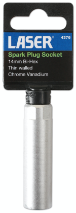

They didn't have the correct size but i managed to buy the Laser one (Part No. 3681) from a motor factors nearby which was more expensive unfortunately, but at least I have the correct one now.

Used a thin walled small 14mm multi-point spark plug socket and I have managed to change the plugs. The socket still caught the shaft but at least it is done now and I should never have to do them again, well not on this car :D Thanks for you support.
