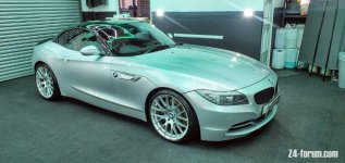

Hi all,
Just a quick one. My 2010 35i is feeling a little tired in the suspension department. On my old E85 I fitted Bilstein~B8's which seemed to do a good job. Just wondered if that is the way with the E89? Currently just a few things done. Sorted the Tesco scratch which some *wat left on the rear quarter. Done gearbox service. Fitted a Wagner intercooler. Serviced new oil, filter, air filter and plugs. Not particularly wanting to lower her but don't mind if it's a small amount. Just wondered what others have used?
Regards
Chris
