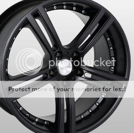

19s , Pretty sure newby "lanky lancs lad" has them on his E85 :thumbsup: they looked good the couple of times ive seen them :driving:
macsbm said:
Would 19s fit ok and would it change the ride would it be a bit of hard ride or not
It would be difficult to go from 17s to 19s without noticing any difference but get the rubber right & you should be pleasantly surprised
What widths & offsets are the wheels ?
macsbm said:
http://www.rimstock.co.uk/content/le-mans
So 19s not 18s ? if so i would go for 255 35 19 rears / 225 35 19 fronts or 235 35 but these may cause a very slight rub on arch liner when spirited driving
macsbm said:
Sorry to be a pain is that trye size or is that what wheel I order what is rim size and offset
They are the tyre sizes , 265 35 19 also a possible if 255 35 not available in whichever tyre brand you chose
Wheels would ideally be 8.5j front with et 40/45 ( no less than 40 ) 9.5j rear with et 40/45 ( no less than 40 )
Just my own thoughts , others may have different preferences :thumbsup:
