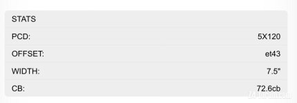

Am looking to replace the wheels on the car I bought yesterday. The wheels are in really poor shape but do have 4 brand new tyres on.
With that in mind, I was planning to buy a new set of 17’s as it seems a little crazy to me to buy 18’s and another 4 new tyres.
The wheels I’ve seen are;
Will they fit OK?
Thanks in advance

Assuming you mean you want a set of 17’s and change the tyres over, as there is nothing crazy about running 18’s on these cars. Those wheels will fit (assuming the CB is OK). They are narrower than your existing “daisies” but have a slightly more aggressive offset, so will sit about the same in the wheel arches. For precise advice, checkout www.willtheyfit.com.

They'll fit, although I'd personally look for wider wheels if possible. Wider wheels = more grip even with the same size tire, and I wouldn't suggest to go under stock width unless you want a more playful car. The max wheel width you can run on 225s is 8.5 inches. I think 225s on 7.5 inch wheel will work, but it will be a "looser" fit and look meatier.
As for aggressive, Zedebee refers to the offset (etXX value giving distance from wheel hub to center of wheel) as closer to zero than stock (stock is et50 or something while these are et43). Also every .5 inch change in wheel width equals to about 5mm offset change. Eg. 7.5 inch wheels et43 ≈ 8 inch et48.
The optimal offset/width combo you can run on our cars to get the wheels in line with the fender (not inside) on stock suspension is 8.5 et35 in the front and 9.5 et38 in the rear.
