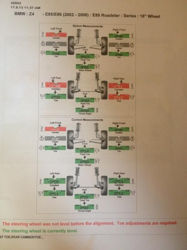

M misskingfisher Member Hereford Aug 17, 2013 #1 Hi, Just taken my Z to have 4 wheel alignment as had uneven tyre wear... They sorted the back no probs, but the front left camber is out (see pic) - and they said it cannot be adjusted...? Anyone got any ideas how to rectify this..?
G Gargybloke Active member Poole & Woking Aug 17, 2013 #2 It is adjusted by loosening the three strut tower nuts and removing the factory alignment pin. Do a search on here.
