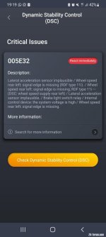

I did scan with carly. But for some reason I don't feel I can trust it for such jobs. More handy for coding I think

But lateral sensor implausible says yaw sensor.

See, the only other things Carly is saying is all about the rear left wheel speed. But that wheel sensor feeds the speedo. So if the speedo is working it can't be that.
