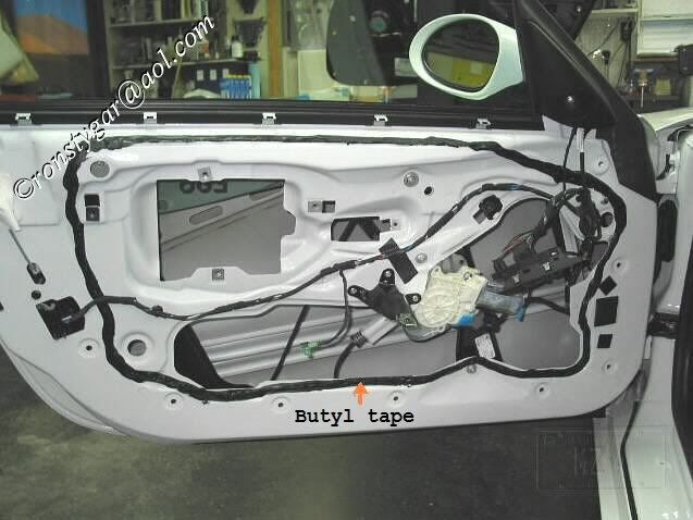

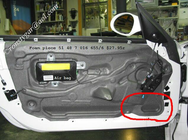

Unfortunately I didn't take a photo when I did it. However I have managed to dig up some photographs from google.
The picture below shows how the membrane will look when the door card is removed. I have circled where the membrane not fixed to the door properly on my car. This gap allowed water that comes in from the window to pass out into the foot well area via the broken seal. If you use a flat object (screwdriver or knife) you will be able to test the seal and find out where the membrane is loose (if it isn’t obvious).
The next photograph shows where the butyl tape is located without the membrane. You can use this to work out where the butyl tape goes. However this will probably also be obvious as this stuff is seriously sticky and it will leave traces behind to let you know where it was!
When you have identified where the gap is apply some more butyl tape between the membrane and the door frame ensuring a new seal is created. This will hopefully resolve your problem!
