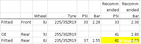

This may muddy the waters a bit, as I am not running 9J's on the rear. You might remember my post from a while back, when I cracked my rears and decided to replace them with 8J's. I now have these pressures. I must stress - the 'vagueness' in the steering came BEFORE I switched to the narrower rear wheels and changed the RFTs to non-run flats.
So I have standard wheels and standard tyres sizes on the front, at the standard pressures. Should I be running a different pressure for non-run flats?
On the back I don't have a recommended pressure for the non-standard size (i.e. I don't know what the yellow boxes should read), so I'm running 37 PSI (the 255 tyres would be at 41 PSI OEM). Any thoughts on whether this should be more/less?

The rears should be around 32-36 psi…
To bottom out the issue I’d start at 32 rear and see how it feels..it’s not going to kill you..

Miles off! MILES off. For quick driving, try 36R/44F. For 'normal', no lower than 32F/40R.
That said, your odd wheel set-up will/may/could - I don't know - skew things.
There is another forum where a ton of pressures were tested on non-run flats & the consensus was 34 psi front / 38 psi rears (standard tyre size obviously) on the 35is with 19" wheels.
There are no quoted BMW figues for non run flats - only the RFTs that are standard fit, so the figures in the book / stamped inside the door (or wherever) are not much use to you.
Any figure you see online (including here) is just made up with a touch of trial & error.
There does seem as much art as science when it comes to deciding on tyre pressures! I'd assumed that BMW recommended pressures for my front (standard) wheels with RFTs should hold true for non-RFTs, but am now tempted to run them with a little more air in them and see how that changes the handling.
For my non-standard rear wheels (19" 8J) I have 235/35 non-RFT tyres running 37 psi - and that is just guesswork, 'cos few people have this configuration. On reflection I might have been better off with 235/30 tyres, but I can't believe it makes much difference and surely the steering 'feel' is way more influenced by the front wheels/tyres than the rear? But I think I will eek the rears up +1/+2 psi too and see what happens.
