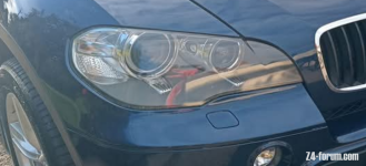

i used UV protective lacquer on my X5 and will be doing the Z4 this spring as soon as it warms up.
I've considered a spray sealant. But my concern is me screwing it up and it looking bad, then needing to mechanically remove it to try again. I can see myself getting in a right mucking fuddle, tbh.
What was the application/finish like?

Rattle can finish was perfect, 3 coats, no runs or drips. The lacquer resists chips at least as well as paint and if it does get chipped I will just cut it back with 400/600 wet and dry and reapply. I was worried it might peel but no signs yet.
