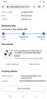

Worked for me and easy fit once you get the centre vents out to enable head unit removal.
Thank you for this - what setting will it takeover on the stereo? I have Radio, CD etc but not sure what would show up with this added?
Use the aux setting on head unit
ah, this looks great, thanks @sw4nny . I'm assuming that you left the Bluetooth dongle behind the dash?
My main question is, if you set the mic up, where did you place it?
Many thanks, Rich.
I managed to get it all hidden behind with no real issue. The only struggle was making sure the wiring look fed back through the metal hole. Also the connection was white sensitive so when I put it all back together I was only getting sound out of the left hand speakers. Fiddled around and got this solved.
The mic I routed okay - it’s a bit visible but works alright for the money
