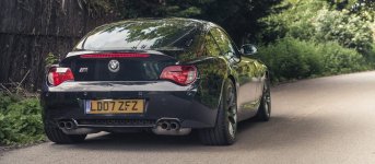

#5 - I'd rule that out completely as the rears are not just too wide (which will rub, catch and wear out your tyre and arch liner), it's also too high a side profile - which will knock out the speedo and make performance/fuel economy worse. I go through a set of arch liners every couple of years in my Z4MC and I'm only running 265/40r18. I can't change the offset to bring it in as the tyre is only about 5mm away from the suspension strut.
For reference, this is my Z4MC on 225/45r18 and 265/40r18 (only the rears are slightly wider), but being slightly lowered (about an inch) on Bilstein B16/PSS10 fills the arches nicely, and still gives me a good compromise between road & track use.
Wouldn't want the tyre any more outset...
