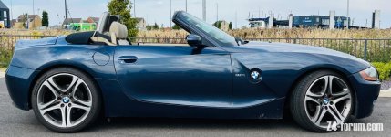

Mine came on the 326's which had MPS4S all round - the rears are 255/35/19 and are due for replacing but the fronts (225/35/19) are still fine .
I've had no issues at all and when I took the wheels off to check them none were cracked or had been welded - suffice to say I will be ordering the same size for replacement hopefully later this :thumbsup: 20220826_120103.jpg
