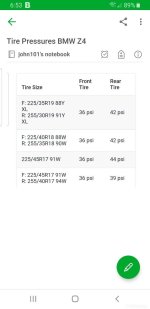

This is from the manual.

The manual is showing tyre pressures for the oem runflats.
Not the non-runflats.
General consensus is to go 3-4 psi lower front/rear on non run flat tyres, and there is no official pressures available from BMW.
