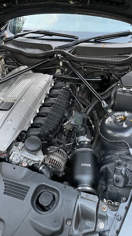

Following this, I created my own home-made intake system, fitted an N54 intake manifold and had the car tuned by Bimmworks in the States remotely with an OTS map. The Bimmworks map with its 7600rpm rev limit and N54 Manifold works really well with my 3.73 FD as the car now pulls a lot harder at the top end. Fitting the N54 manifold removes the DISA valves, which helps reliability but doesn't help midrange performance unless you tune the car.
IMG_4410 by Damien Bower, on Flickr
The results has certainly woken the car up. The car feels like it comes on cam at about 5000rpm and really pulls much more strongly to the higher redline. This makes the engine feel more special and more of an event to drive. Peak power is now claimed to be at 7300rpm rather than 6600rpm

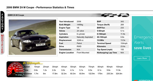

Interestingly, according to these details I found online, the Z4M has a power-to-weight ratio of 229 BHP per tonne.... although it isn't powered by a V6
It also states the Z4M covers the 60-100mph dash in 6.8 seconds
IMG_4526 by Damien Bower, on Flickr

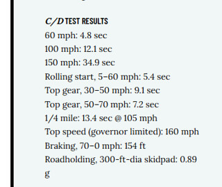

Car and Driver tested the Z4M in 2006 and listed it as 1500kg, with a 60-100mph time tested as 7.3 seconds.
Screenshot 2025-11-26 184250 by Damien Bower, on Flickr
Link to data is here: https://www.caranddriver.com/review...2006-bmw-z4-m-coupe-vs-2006-porsche-cayman-s/

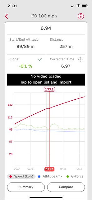

So following my mod, I retested my car on the flattest road I could find and managed.....6.97 seconds 60-100mph!!
6ee9ed4e-0778-49b4-879e-4178439e6ba2 by Damien Bower, on Flickr
Not to bad for a FD change and £650 of mods!

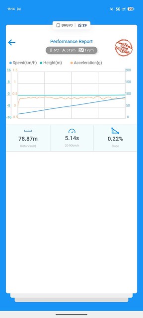

Then a Z4M owner mentioned that he'd tested both his 3.0si and Z4M in second gear from tick over to redline in seconds over the 20-90kph metric. This is an interesting one as my mods lose a little midrange power, replacing it with top-end power, so a full sweep of the rev range is great to see. Also it removes traction as an issue and also wind speed.
His 3.0si did it in 5.14 seconds

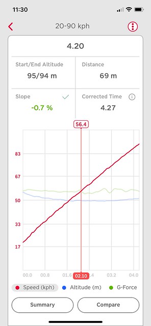

So I took mine out, it just scraped past 90 kph as it headbutted the limiter, but it did it in 4.27 seconds
IMG_4532 by Damien Bower, on Flickr
IMG_4410 by Damien Bower, on FlickrThe results has certainly woken the car up. The car feels like it comes on cam at about 5000rpm and really pulls much more strongly to the higher redline. This makes the engine feel more special and more of an event to drive. Peak power is now claimed to be at 7300rpm rather than 6600rpm
IMG_4526 by Damien Bower, on FlickrCar and Driver tested the Z4M in 2006 and listed it as 1500kg, with a 60-100mph time tested as 7.3 seconds.
Screenshot 2025-11-26 184250 by Damien Bower, on FlickrLink to data is here: https://www.caranddriver.com/review...2006-bmw-z4-m-coupe-vs-2006-porsche-cayman-s/
6ee9ed4e-0778-49b4-879e-4178439e6ba2 by Damien Bower, on FlickrNot to bad for a FD change and £650 of mods!
IMG_4530 by Damien Bower, on FlickrHis Z4M did it 4.4 seconds
IMG_4529 by Damien Bower, on FlickrSo I took mine out, it just scraped past 90 kph as it headbutted the limiter, but it did it in 4.27 seconds
IMG_4532 by Damien Bower, on FlickrTo say I am over the moon with the results is an understatement. The difference is plain to see, and the car feels so much more alive, especially with the raised rev limit and the way it pulls past 5000rpm.
