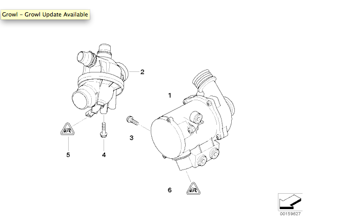

It's at the front lower right of the engine, sits right on top of the water pump. The electric bit melts a wax core so it opens earlier. Otherwise it's strictly mechanical. You should be able to take the housing apart to test, though it is permanently attached to the lower half. It is a 103C stat, so you need to test in coolant.
