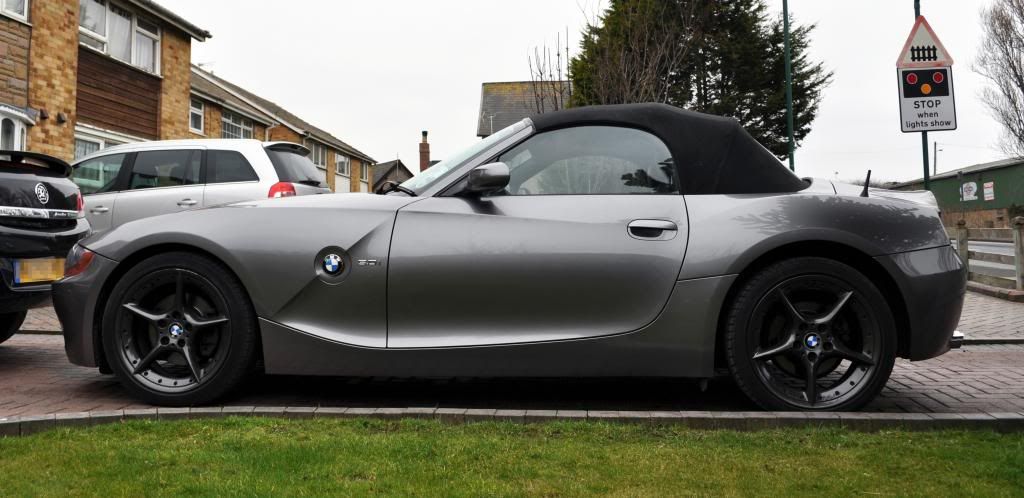

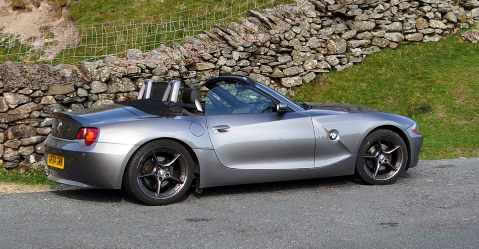

looks quite normal tbh. here's mine before lowering:
Marius said:
Looks exactly as my car before lowering, get your self set of lowering springs .
in case you have missed the picture
But your being. 2.5 wouldnt have sport springs unless equipped after :unsure:

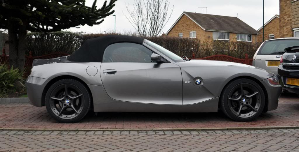

I will deffo be going down the lowering route, i want it back to the high i had before plus the car is still lopsided and you can notice in the flesh, so gonna try and get the garage to fit the lowering springs and refund me on the oem springs
What springs would everyone recommend?
I popped the car over to the garage that fitted the springs but couldnt get me in till thursday this week, but they said it doesn't look right at all plus me and dad have both lost the back end and we'll just say my dad does drive fast.

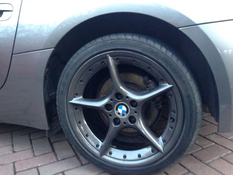

So while the wheels were off i took the opportunity to paint the callipers, what does everyone think?

Don't like that yellow calipers at all.. :fuelfire: gold would classy but yellow screams too loud :thumbsdown: but it's up to your taste whether you like it or not :thumbsup:
