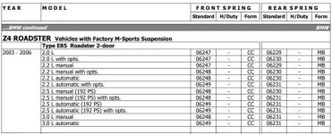

Could someone tell me the part numbers for the Suplex M Sport springs please as switching to Bilstein B4's and want the m sport springs as 30mm is too low for the roads near me so 15mm will do.
I cant seem to find the threads I was looking at. I think fronts were 06248 but cant remember rears.
I've emailed Suplex today asking the same question.
My research suggests:
Front =06248 (manual transmission)
Rear 06231
mines a 3.0 e85
Awesome, thank you. I did save it somewhere but cant find it now. At least the fronts were right :)
Mines the 2.2.
Guessing these springs will give the 15mm drop?
https://www.ebay.co.uk/itm/Fit-with-BMW-Z4-E85-Front-Suplex-Coil-Spring-in-Pair-6248/392113089699?fits=Car+Make%3ABMW&epid=1063368755&hash=item5b4bc2eca3:g:5NcAAOSwBP9bhrKr
https://www.ebay.co.uk/itm/Suplex-Coil-Spring-Rear-Axle-OE-Quality-06231/292040912476?ssPageName=STRK%3AMEBIDX%3AIT&_trksid=p2060353.m1438.l2649

In theory you'd need 6230 if your car is a 2.2 manual (with options). I have a pair of 6230 springs you could have for next to nothing. I have fitted them in January and covered maybe 150 miles since. I have ordered 6231 but got the 6230 by mistake and only realised after fitting so no chance to return.
Let me know if you're interested. I know people are (correctly) unsure about used springs, but I'm not sure if these really qualify as "used" :)
What is meant by "options"? I'm struggling to think of something that would mean fitting different rear springs
I think it’s about the overall weight off the vehicle. Someone here found a BMW software that changed the OEM spring part number depending which items you selected as fitted to the car.
I'm assuming "opts" means "optional M Sport suspension".
The 3.0 pre-facelift all came with it whereas the rest of the range had it as an option which supported that.

That sounds sensible, but then I noticed that the above table is titled 'vehicles with M Sport suspension', and only the rear springs differ with the 'options'. So I'm still puzzled...
