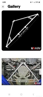

I have finished the front suspension on my car along with an MHD stage 1+ tune. Car runs great and the front seems good but I am noticing a loose feeling in the rear on acceleration and I am not breaking traction,it just seems to sway back and forth. What do I need to upgrade in the rear to get rid of that??

I think the lower wishbone bushing at the wheel is shot (I can move it with very little effort) ,the one at the diff seems to be fine (no movement) also the one at the trailing arm front will be replaced as I already bought the uprated full rubber,stiffer one for it along with the spacers.
I see you have one of the two bushes 2,3 for the ball joints but what you almost certainly need is 4..
Obviously 6 and 14 may be worn..but its 4 then 2,3 that are the priority.
You may find 18 doesn't give youe nough adjustment on toe in FWIW
Assume ride height is stock tehn camber should be able to be brought in...
FWIW even new those adaptive dampers were not the greatest..

I have ordered 3,4 and 6. I am at stock ride height so I do not believe I need to change 18... I know the stock adaptive shocks are not the best,but I don't think that is making the rear end seem like it is steering left and right under acceleration .
