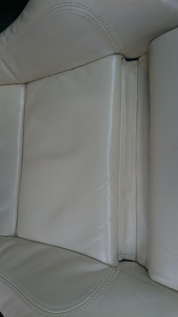

When I bought my Z I had a few jobs that I wanted to do but mainly sorting out the tired looking drivers seat!

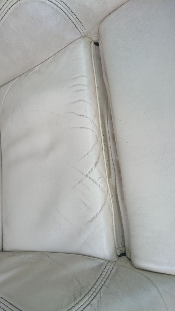

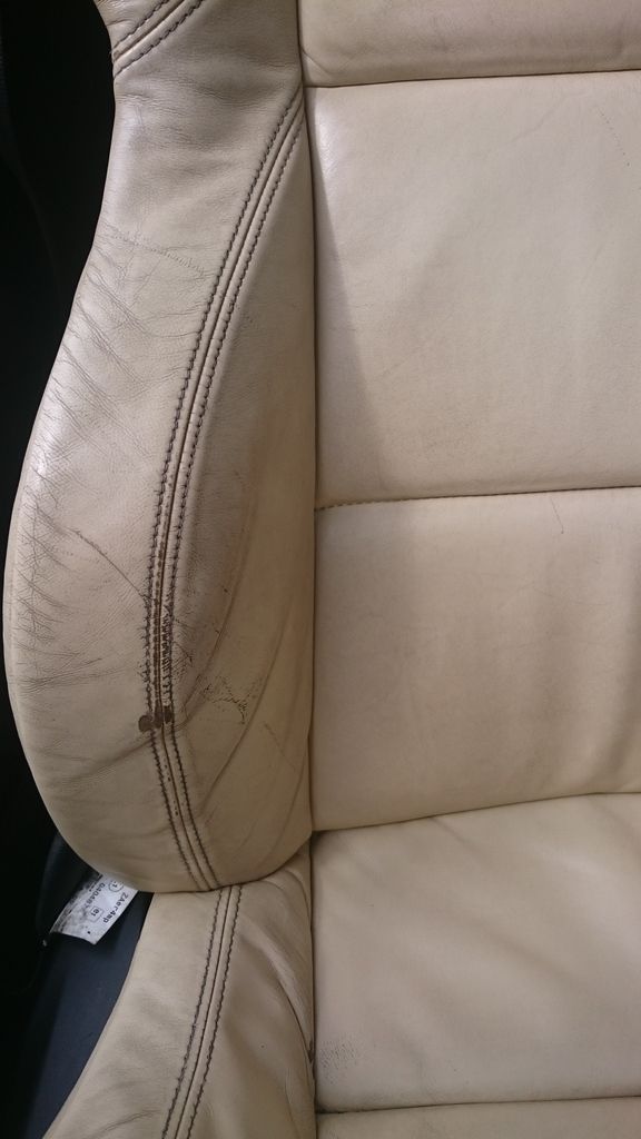

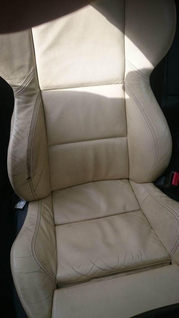

I actually had the stuff ordered to do it before I even picked up the car but not had a free warm weekend with the car as some plonkler scraped my rear and so been without it... Anyway here's some before pics of the seat condition

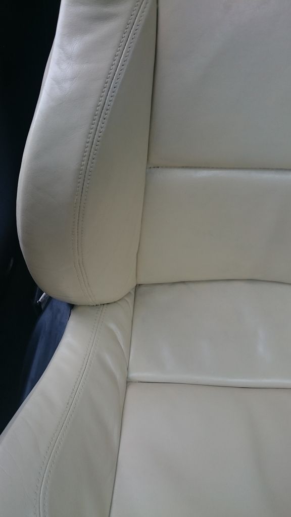

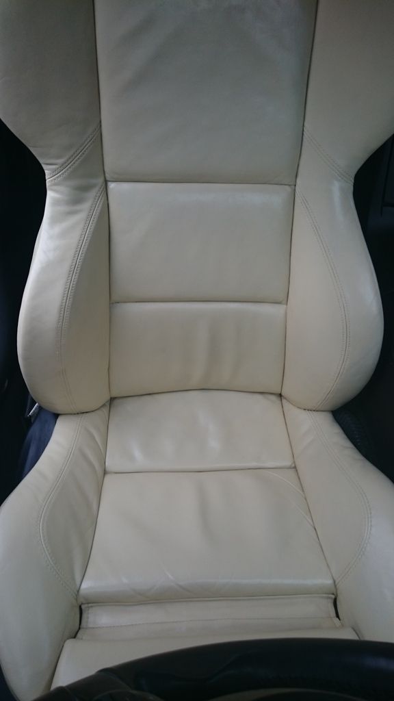

And after a good bit of graft
Was only planning on touching them up but once I started prepping them I decided they were bad enough I may as well recolour the whole seat.. They aint perfect but I am really pleased with how they came out especially as a first attempt....
If I was going to do this again I would take the seats out of the car first as it would be much easier, I'l also get an airbrush to apply the colourant and sealer as its a bloody nightmare trying to get it neat with the sponges, and there were a few bits I had to strip back and re do

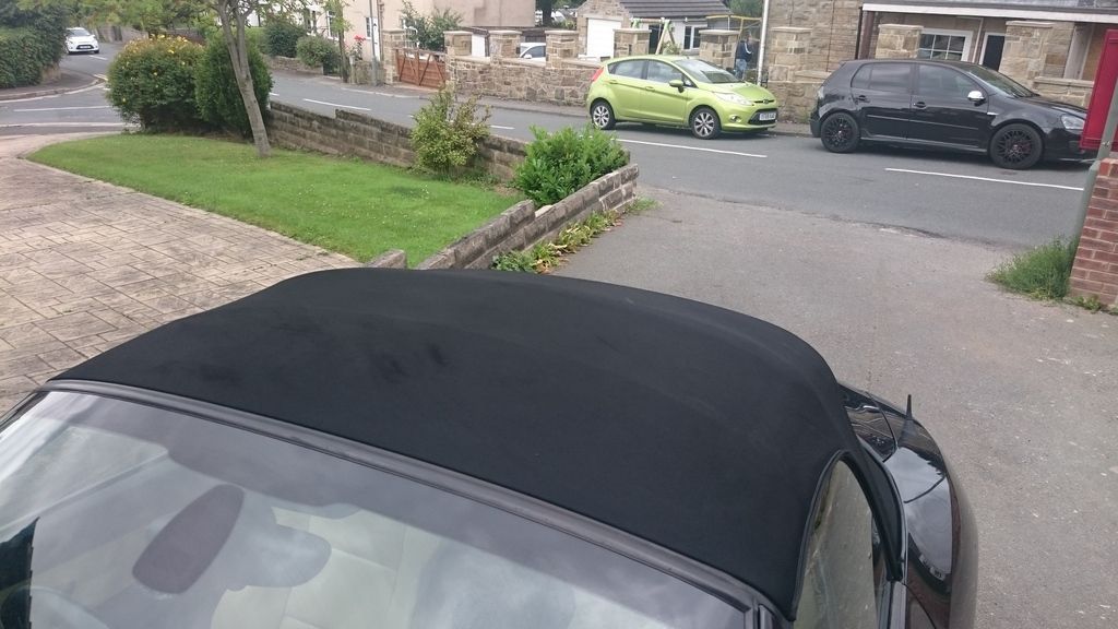

This job was speeded up with a hairdryer but still quite a bit of waiting time between coats for it to dry so I managed to get the roof cleaned and conditioned. I used Mr Wilks' trick of mixing some shoe polish in with the conditioner and I have to say I'm impressed with how it worked sorry forgot to take a before pic

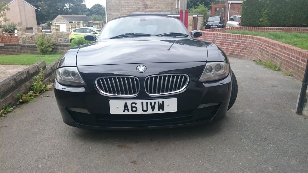

Also sorted out the headlights where they were starting to mist up only slightly but I gave them a bit of a polish with the formula one headlight restorer I got for my old Z forgot the before pic again but this is what they look like now

Yeah sealed em with the sponge, that was a bit of a nightmare too to be honest did the first layer too thick and had to strip two of the panels and start again...
I was worried about applying the colour too thick but found a tip online to dilute 50/50 with water and do more coats which seems to have worked
