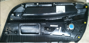

Just checked the oem catalogue... they don't appear to be the same as door speakers... 4 screw fixings on the door speaker, 3 on the behind seat speakers...
But I think a woofer in the door will be too bassy, I think a full range will give more..well..range! The mids and tops are deffo needed...

Slightly confused now...
The oem catalogue shows a sub woofer with a 4 screw fixing..
However, after looking on fleabay to check the door cards to check the fixings they all appear to have the same 3 screw fixings as the behind the seat speakers.
So I'm guessing yours may fit :|
If they're still available I'd like to buy them direct please :) Can do paypal
