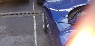

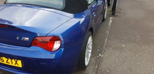

Spacers fitted
Probably look better if the car was lowered , if not lowering id fit the fronts on the rear & leave the fronts without spacers (or maybe 5mm )
As they are now the fronts look out of the arch in the above pic

20mm rear and 15mm front :? :oops: . I thought if you going to have spacers at least make them noticable. Kerbers paradise!
Did a quick search and can see that your CSL reps have higher offsets than stock - ET37 (and 18" x 8" all round?).
Most OE wheels are ET47 front and ET50 rear, so if somebody with them recommended you 15mm and 20mm, they will look like stock +25mm front and +27mm (ish) rear on your car.
From that pic I think they look awful, sticking out too far, looks like you've fitted the wrong wheels to the car.
Also, the M badge might be skewing my perception, remove that and the spacers might look better.
They are further out than I would want them, but it's your car so it's up to you!
Well I think they look ok, seen in the 'flesh' the stance looks menacing. If I fitted 5mm ish and all that, then they hardly make a difference, then why bother at all?!
Front and back stick out to far. I think it's best when you can line up the arches with the face of the tyre.

If Carlos Ferdango can have them then so can I....so there!

The spacers aren’t to bad, it’s the “m” badge I’m having issues with :oops:
Rob
How can I Photoshop the M badge so next time no one on the Forum will be able to notice it?
The best way to do that is by using some dental floss in a sawing motion, a waste bin placed underneath the badge can be used to dispose of the (tawdry) evidence :P
