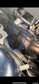

Had another look today, what you’re saying seems to check out, think I found a small leak of oil and it dripping down onto something causing it to burn.

Cam box gasket fails or cam box gets a crack..due to slant of engine oil always drops on the hot headers ..Simple’s :thumbsup:
This oil leak looks like it could be the culprit. Seems a screw could be loose allowing it to seep out once hot.
