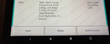

Few weeks ago the airbag warning light came on on the dash on my 2003 Z4 (E85) and local garage code reader showed error code 9852 - SBSL: Short Circuit, Firing Circuit, Front Airbag, Left, Stage 2 (E85), SBSL (Satelite, B-Pillar, Left).

Yes, paid one garage to run diagnostics who directed me to BMW specialist who I had to pay again for diagnostics and quoted me £600 so really don't want to pay a third time. Am I right in thinking if I have the error code 9852 as screenshotted then there is only one possible sensor unit it can refer to?
If so, is it shown on the diagram BMW sent me? I don't want to risk them fitting the wrong part that doesn't solve dash warning light issue and charging me £340 for doing so, however can't face paying them £128 more for no reason either.

That code you have is definately pointing to the SBSL module, usually down to water ingress when the hood motor pump cavity gets blocked an fills up with water and overflows down onto the module. This is why its prudent to check the drain on that side for blockages.
Putting a known good replacement module in and coding it to the car looks like the way to go. I dare say if you take it to any garage they will want to diagnose it before fitting any part and charge you again.
