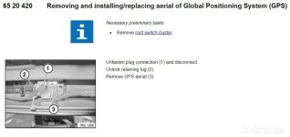

Picture from newtis.....
It's above the interior light (according to that)
That is where it is my car under the cabin lights. Is it bonded to windshield?
Does it get removed or come with new shield, i need to take a closer look.
