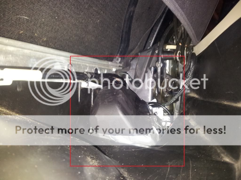

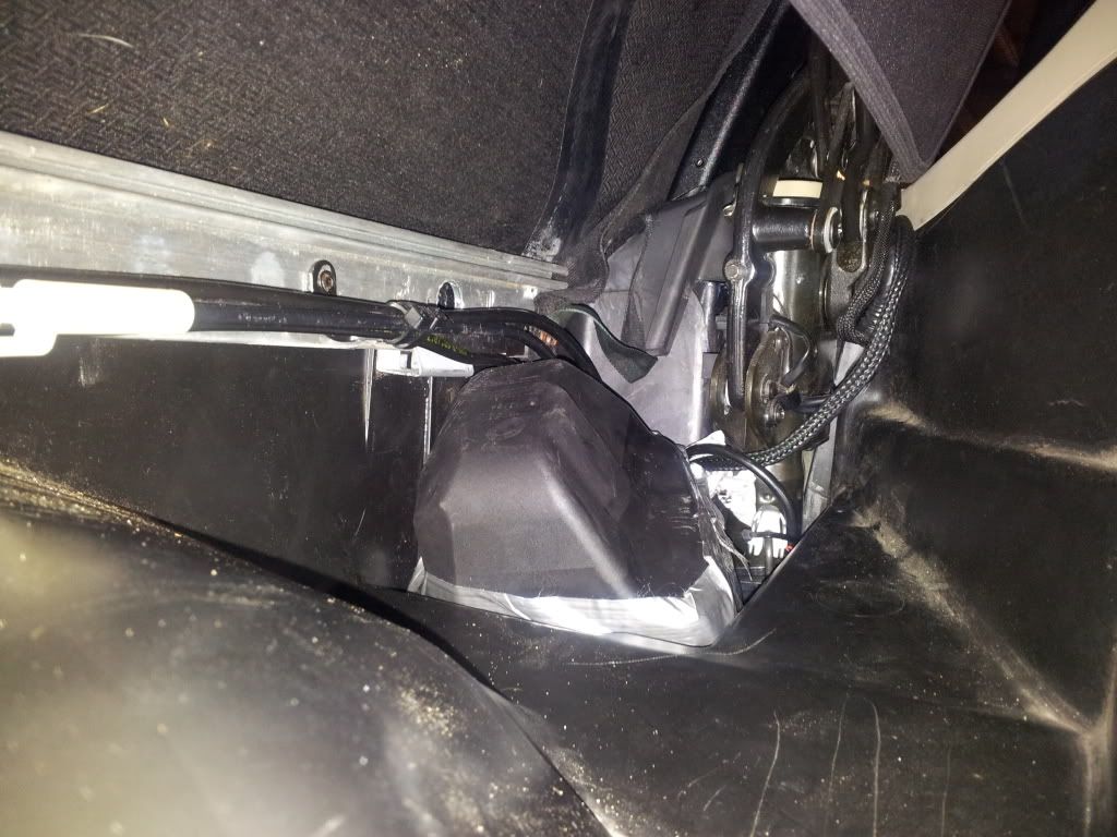

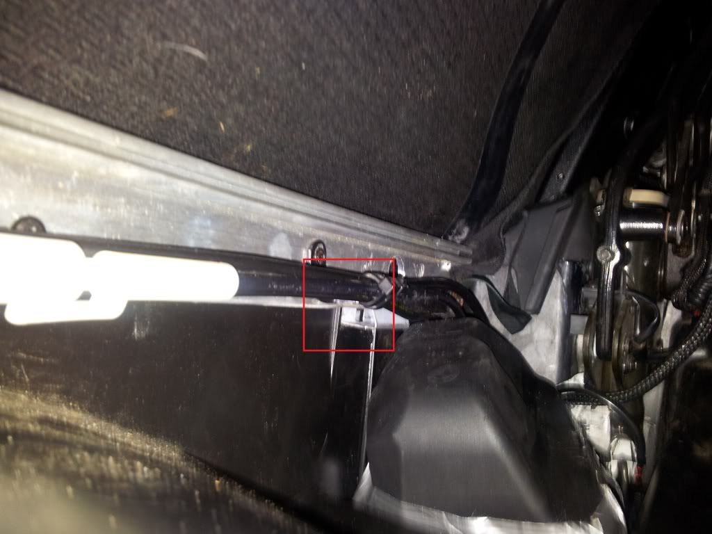

2. When I open the boot, remove the plastic of the roof compartment and look at the roof motor is almost looks like the compartment is too high up and not properly in place. I am however unable to push it in further and would probably have to take off the roof to check. I have a feeling that the motor may be pushing against the roof which is why it doesn't open fully and the red button starts flashing. Also, it almost looks like the hoop isn't fully snapped into place. I have taken some pictures:
Can someone maybe confirm if their's looks the same? Or even better can someone maybe take and post a picture so I can compare?
