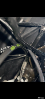

Has anyone any experience of replacing the hydraulic roof motor hose number 11? Mine looks like it needs replacing, not sure if it can be done without removing the roof?

Remind me, Does 11 run to the passenger or drivers side ? (I’ve done both in the past )
The roof doesn’t have to come completely out but it’s a fiddle and the drivers side is harder to do of the two.
Either myself (in Bristol) or Ross (Hampshire) can do it fo you if required and you’re local enough to visit either of us ?
It’s the passenger side mate, just runs to the motor but not sure how it disconnects? Looks like some kind of white plastic clamp and tie wrap?
