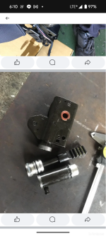

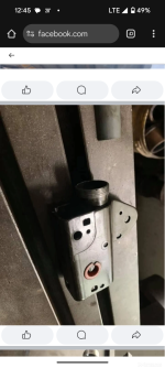

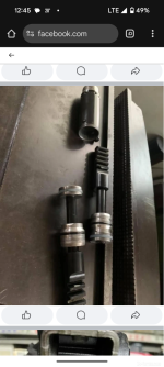

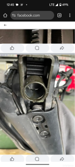

Nice, the Chinese kit was expensive due to the CNC plug. All the other materials are cheap. Due to my recent experience of rescuing hinges that has been leaking after some other shop tried to rebuild them, the main leak is from the reused CNC plug. Maybe you will be lucky that the plug will last longer for a while, but highly chance they will leak.
From the picture you can see
1. reused CNC plug that leaks
2. someone attempts to cut a second O ring groove but still leaks. Can't hold the pressure.
3. The redesigned CNC plug, the O ring groove is higher, this has 2 benefit, a: it sits at the area the has less chance to be damaged during the removal process b: it will have thicker metal between the O ring and the drilled holed that holds the plug and strong enough to take the pressure without changing from and cause leak.
