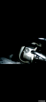

You mean where I circled?
(Pic borrow from another thread)
It was flooded with water but not that high
It there a O ring that seals the pipe that goes to the cylinder?
Yes that's where they fail.
No o-ring. The pipes 'kick' a little bit every time pressure goes through them. Once they get rusty they eventually fail right on the outside of that bend.
Thanks for advice!
I've used scope to look around the cylinder, seems not from the bottom, maybe from other pipe...?
I think the only way is to take all roof out and exam where is leaking before I order 2 rebuild hinge...
