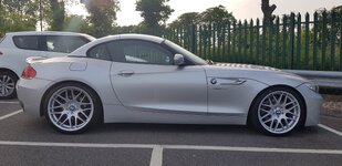

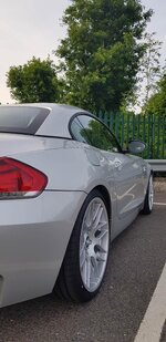

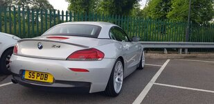

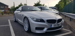

Dave, here you go .... showroom pic from just before I collected it ....
And more recently with the Eibachs fitted ....
The front drop is more evident but that was ideal ....... drives more directly and hopefully if I go for the Rivas with non runflats should improve again ......

Thanks for the pictures, car looks great in silver and in fantastic condition.
I much prefer the lowered set upof your car on the Eibach's and with slight rake towards the front. Whilst I love the look of the 326 wheels I look forward to seeing the new wheels and it is great to see owners efforts to personalise their cars.
Would be good to hear effects of new suspension /tires on the ride quality.
