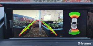

Yes it's possible to have a retrofitted reversing camera, and you have a couple of options....
1, As above fit an MMI box to your current iDrive, this will also give you full Apple CarPlay/Android Auto from your phone. You then simply connect and run a suitable reversing camera to this. All plug-n-play, so no coding required.
This is the screen view you'll have (you can have it in full screen, but the sensor view will be over the right side of the image)
