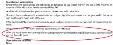

So we just ignore this part of the BMW retrofit-instructions then? :
well that explains why the dealers think it needs coding, but I know for a fact it did not on my prefacelift an everyone who has posted on the forum about fitting to a facelift model said no coding was needed
That's just to update the Vehicle Order. Works without it. Make sure they disconnect the battery until all assembled. I managed to blow a fuse fitting mine when I put the blue cable straight into the pin without the black repair cable added on.
