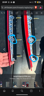

Wow, what a fantastic forum. Thanks so much for your informative comments. Here is where we are: The replacement brake light that i purchased online, that claims to fit the 650i, and which I expected to fit the 2007 E86 Z4 Coupe, is shorter than the stock light. The light I purchased is similar in construction but a couple of inches/cm shorter. I will return the incorrect light and go off in search of the correct replacement part. Also, as noted above, the trim panels are indeed snapped into place tightly. Unfortunately, again, while removing the left trim panel, the left rear window defroster wire snapped the solder connection to the window. I will report back after addressing these two repair tasks.

I wonder if you could unclip the lens from those units and swap them over? The clips and mounting bolts look to be the same location. Looks like just black plastic clips from the photos (but maybe there is sealant too?)
Very interesting. I am thinking I will try your solution. I am out of town. Will provide follow-up when I return.

I have returned after traveling out of town. I examined a third brake light for the 650i. Although the black body of the light is identical to the body found on some Z4 Coupes, it cannot be used in any manner on the Z4. The LED lights are installed into the lens. The black plastic body is plastic only, with a wire that connects to the combination red lens and LED lights. The LEDs are buried inside the red lenses. I can't think of any way to swap the lenses that are mounted onto the same black plastic body in any useful way because the LEDs are manufactured into the red lenses, thus not exchangeable. The red lenses covering the LEDS are glued tight onto the silver metal part holding the LEDS. Three parts: 1. black plastic mounting body, silver metal unit holding the LEDs, and the red plastic lens.
