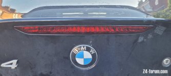

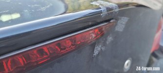

dgmx5 said:
Removed the existing, cracked, light with a bit of persuasion including a hammer and chisel as two of the plastic housings in which the bolts are held had cracked so they were just spinning as I tried to remove the nuts.
Not too bad getting it out.
Fitting the new unit from BMW_Direct on ebay should be a breeze, no? Well I can't seem to get the unit to sit in the opening. Partly I think because the seal has a lump in the top right hand corner, see photos below (excuse the tape marks, I had to tape the old unit whilst I waited the arrival of the new unit)
Any suggestions as to how to improve the fit before I go for a final tightening of the nuts?
TIA
Photos above.
I trimmed that bit of the seal back and it is now fairly flush. According to the invoice, it came from BMW Park Lane. I can't see me ever buying a car from Park Lane.
