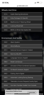

Tried bimmer.work a few times from different devices and it just doesn’t like my vin. However, I did get a result from another site and it gave the attached breakdown. I don’t see any of the MOST related codes you mentioned but have included everything here. The spec appears accurate and correlates with the original options list.

Would be really grateful for anyone’s expert knowledge on whether that means I could just add a head unit or if there would be secondary issues in doing so.

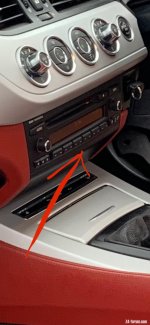

As mentioned that ‘09 professional head unit does have a few more general computer functions attached to it, operated via the generic buttons I’ve pointed to in the last attachment here, I believe. However its not clear to me whether I’d be losing anything useful if I didn’t have them!
694, CD Changer is connected via the MOST network :thumbsup: so if you went for the aftermarket setup then you'd loose that, but probably no issue there.
Cheers - it doesn’t have the changer so reckon that must be for a harness / adaptor or something, which is fine as to be honest I’m ok without cd’s - appreciate your help with interpreting this, thank you
