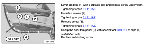

remove door trim driver side
https://www.realoem.com/bmw/enUS/showparts?id=LM51-EUR-07-2008-E89-BMW-Z4_30i&diagId=51_7323
https://www.realoem.com/bmw/enUS/showparts?id=LM51-EUR-07-2008-E89-BMW-Z4_30i&diagId=51_7453
Are they under the armrest pad unsure if that clips in
passenger side is ok, thanks
I'm more than certain now, that there are no screws at position #2, driver side
I'll report back

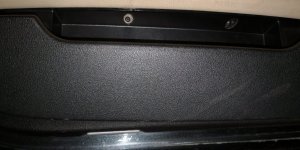

Thought i was going to have to remove the door cardc also.
Before i did, got a pair of bent long nose pliers first and after a 20 minute battle got the puddle lights fitted :D
