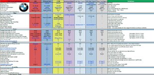

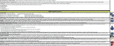

Below is an comparison sheet I have lifted from another forum
Twin Turbo said:
Wow you have loads of options.
I had an E92 335i - so same engine.
Rolling road tune - is very good as the tune is tweeked to your car and preference - but do a lot of research on who you use.
Cobb - very flexiable and you can default to stock - get great reviews
JB4 - very flexible and you can start and lots of additional features
Racechips - stage 1 - but they offer engine warranty
That chart is so outdated it's useless.
COBB and Procede are fossils and the JB4 is quickly following them!
