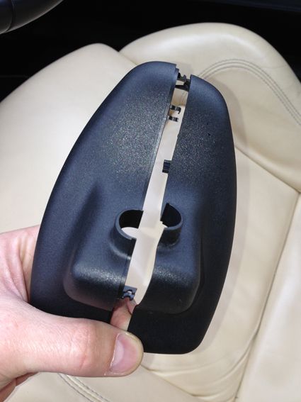

2. Press down on the left hand half of the cowling behind the mirror to release the two halves.
Here are the two halves in more detail and the links between them:

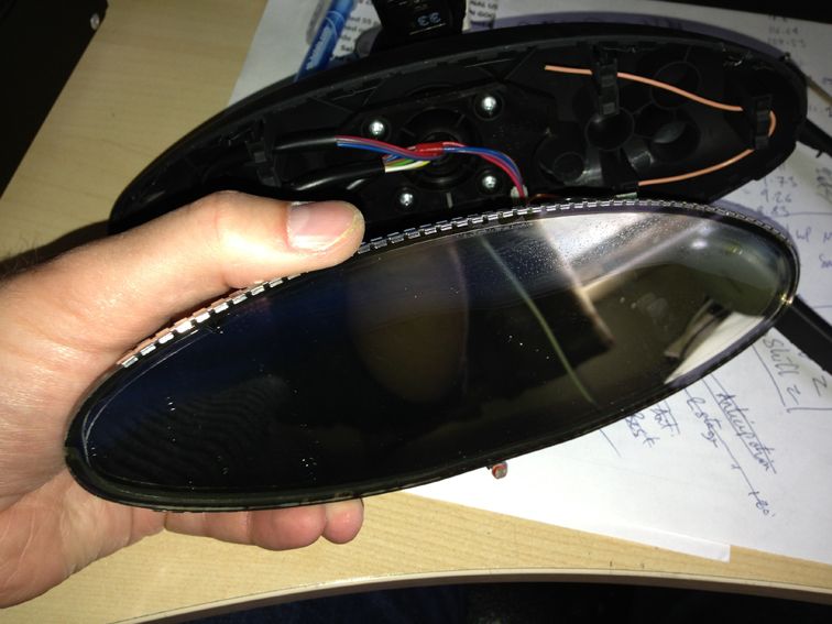

Below are the picks of the mirror interior just for interest. I replaced the old mirror due to the autodimming liquid crystal leaking through a faulty seal. The clips holding the two halves of the mirror housing were very tight and were easily broken, so if you plan on doing some repairs or DIY projects that require splitting the mirror, take care!
