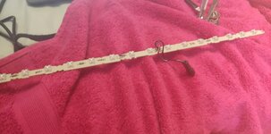

So recently I noticed the 4 LEDs on right where intermitently working, but if they was off pressing on the plastic turned them on
Its easy enough to get to LED unit, take panels off 2 screws where parcel shelf clicks in, 2 screws in hand holes, rest are clips
5 x 8mm deep socket to remove unit, and it can be pushe out, theres 2 little clips
The ends are the hardest to unclip, I heated them up in the hope not to break them off

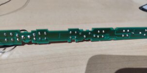

All the components are through hole, simply applied new solder to them all, cleaned with IPA, then clipped it all back together
Cleaned hole in boot and around the plastic of dirt and its all working
