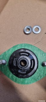

Out of interest my new shock mounts came with nuts and washers but they aren't locking nuts like the original bmw ones is this right?
I'd be tempted to just got to BMW and get the correct nuts.
07119905374 - they're 90p each.
From what I've read I think the original bmw nuts are reuseable, real realoem only says the lower bolt and top shock nut need changing,
The original nuts appear to have some sort of deformed thread at the top of the nut that locks it in place, if I'm correct they are reuseable
