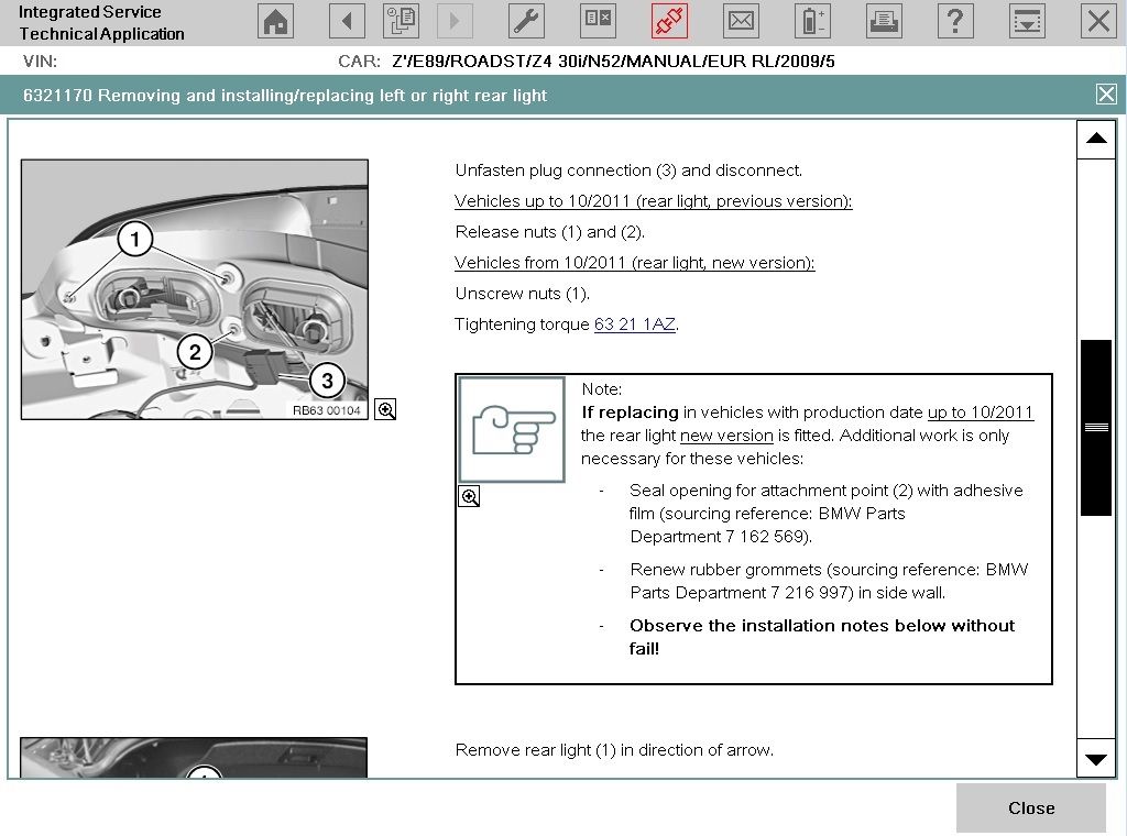

I don't doubt there is a problem with the rear seal leaking but there is another significant problem where they split also. This has been validated by the fact that BMW have actually stopped using three studs on the back to prevent the splitting, which I have now seen on several cars. The new clusters Post 2011have only 2 studs and they use a piece of adhesive film to cover the hole when retrofitting onto older vehicles.

2010 BMW Z4 Technical Service Bulletin 2010/11/01 NHTSA #: 10041281
Service Bulletin #: SIB-63-14-10
EXTERIOR LIGHTING:TAIL LIGHTS: BMW: THE REAR LAMP IS NOT WATER TIGHT DUE TO CRACKS DUE TO STRESS. WATER MAY ENTER THE LAMP. *RM

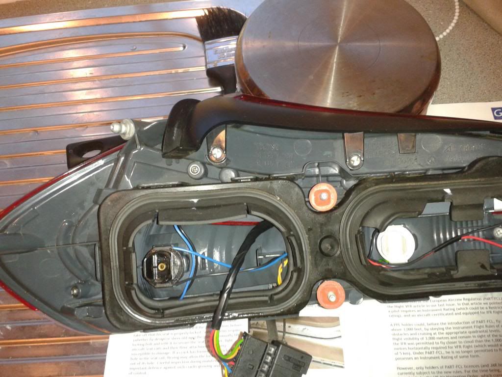

This is the lamp removed.
The two oval cutouts form the rear clip on unit
Take the clip on unit off reveals a rubber sealing strip.
This is made from porous rubber which allows moisture to get into the lense assembly. I coated this in silicon sealant and reassembled and refitted hoping this would cure the problem. it did to a large degree, but there was still some moisture. So on the second go, i left the clip on unit on and used a whole tube of silicon around the join between the clip on unit and rest of the lamp assembly. Sorry i have no picture of that. This cured my moisture problem. So basically the design is bad and the rubber seal they use is made of the wrong stuff to compund matters.
This shows the lamp after a quick wipe over. You can still see the muck accumulation. Water runs off the shiny black trim top right and pours over the clip on unit. Constant soaking the area where th rubber seal suposed to keep water out.
