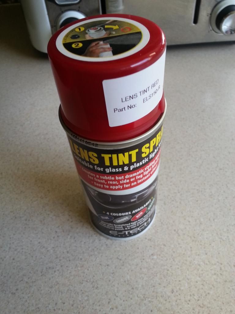

Then some red tint spray, again ebay

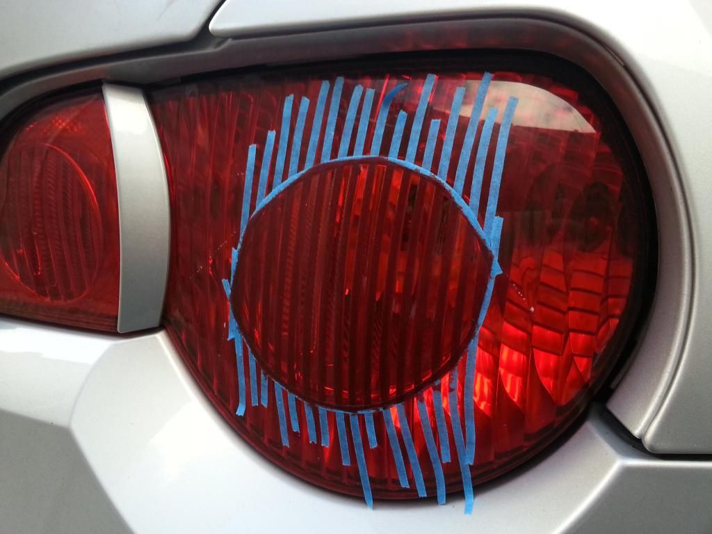

now you're ready to mask.
use the fineline tape and follow the lights natural lines, go straight down and keep a 3mm gap between. you can make the gaps narrower if you like, this will result in a redder looking lamp but may degrade the orangey-ness of the flashing, which we're trying to avoid.
once the vertical masking is done, mask around the circles with the fineline.
then get the wide masking tape and go around again.

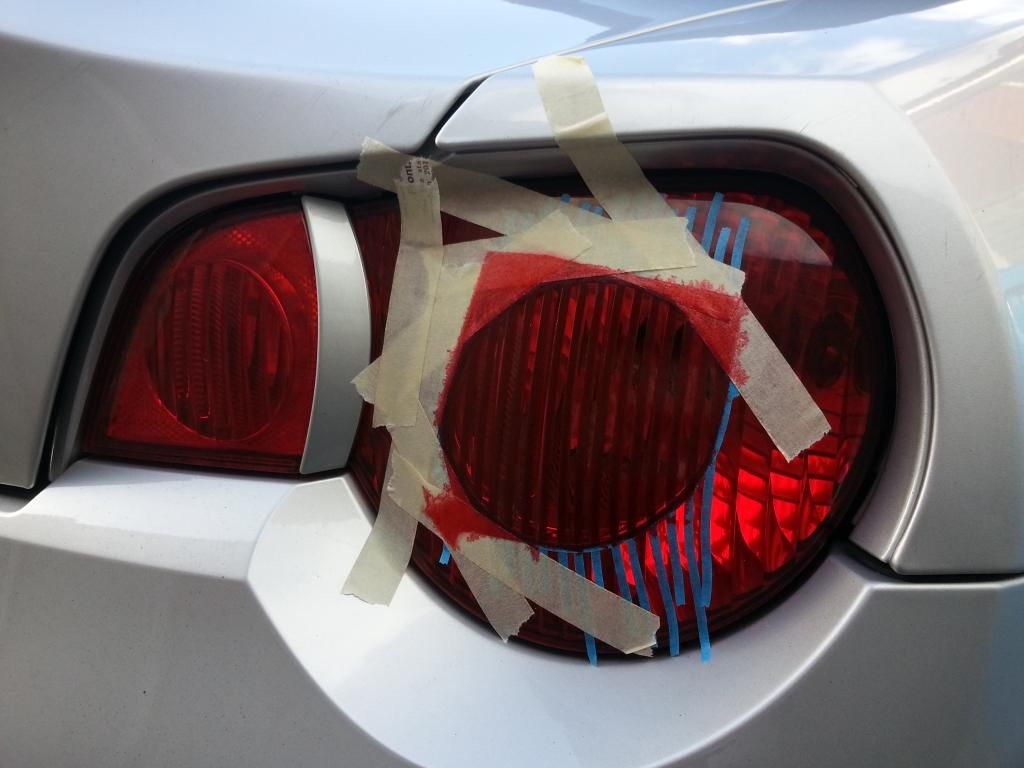

now mask it off with the paper. mask a good 10-12 inches from the light to avoid overspray, as so
Give the can a good shake, at least 90 secs, and apply the first coat using up and down strokes. keep the can 6" from the light, and just dust it on. you don't want it to run.
here's first coat
now repeat for the second coat, but this time go left-right strokes.
heres second coat
now repeat again for the 3rd time, up and down strokes.
that's enough tint now. leave it half an hour and peel the masking off carefully in stages
