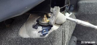

- unbolt the two side hinges- usually a T30 and a 10 or 13mm bolt, with a plastic peg grommet- remove from car. This is to access the two tops of the rear suspension turrets.
- the turrets are covered with insulating and sound deadening so worth a dig around to see the two 13mm bolts either side that hold the top of the shock in place

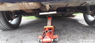

I only needed to change the rear shocks (dampers) today and thought I'd share an easy way of doing it without having to remove the wheels -
1. Remove rear shelf & gubbins.
2. Chock front wheels
3. Jack centre rear of car until tyres are only just on ground (& place axle stands just in case).
4. Undo top shock bolts completely (13mm)
5. Undo bottom shock bolt (18mm)
6. Strut drops out without effort.
7. Refit new strut with bottom bolt & lower height of jack as necessary to get top bolts on.
