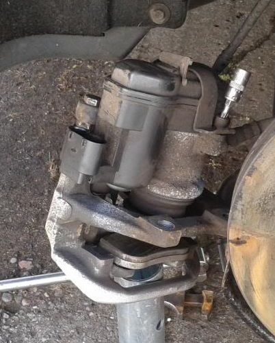

Take motor gearbox off the back by removing two torx screws, then wind piston back with torx bit.
Will be doing this again in a few weeks to fit some vented discs rear.
The torx bit fits inside the centre with the c clip.
I find it easier to remove the caliper completely and easier to paint.

Picture with motor gearbox attached.
Looks pretty simple, good for the future when I need to do it.
One last thing, how does the motor work the piston?
Does it have a bit sticking out that engages with the torx bit that you turn the piston back with?
Yes.
If while apart you paint the calipers, give them several coats, as the rears are steel and the rust tends to break through the paint.
