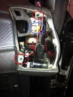

I removed the right vent cover -- one Phillips head screw in the upper right corner, and one in the lower left, behind the drink holder (the holes for both are circled in red). I found a nice place to tie off the ground line: a 10mm nut secures the air passage tube to a bolt that connects to the frame (blue circle). I cut off the ground wire here and crimped on a ring connector:

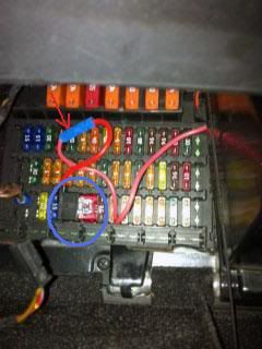

I tapped power using an Add-A-Circuit fuse tap http://www.amazon.com/Littelfuse-FHA200BP-ATO-Add-A-Circuit-Kit/dp/B0002BGELQ I installed it in fuse slot 6 -- a 10A, ignition-switched line that runs power to the reversing light switch. Slot 2 is actually a switched spare, but the dealer used that one when they installed heated seats. Here, I used an in-line Posi-Lock connector:
