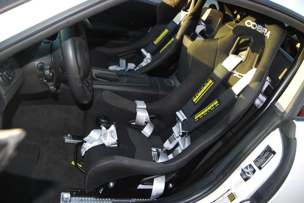

Hi, I have searched the forum but I am unable to find any info on fitting a racing harness. I know that there must be owners who have fitted them , especially if they track their car seriously and or race, but I am unable to find details.

My car has the M sport racing seats, which are great but the issue is the restraing harness !
Fitting a '5' point harness would be a huge improvment in the driving experience, not only on track but on nice country roads , when the oppertunity arisese :)
I simply put in better seats in my Z4MC...Recaro Pole Position ABE in Black Ambla & Alcantara...and the combo if a much better seat (better thigh/hip/rib support) means the standard 3-point belt is fine for trackdays & fast road.
The racing harnesses I have seen fitted have usually bean attached to a roll-cage or rear tower bar...but I'd not use them in a road car.
The posts below refer to e85/e86 Z4s, but similar options (seats/rollcage/harnesses) must be possible for the e89...not that I've seen any outside of proper motorsport cars...maybe the folding metal room restricts what can be fitted to road cars (i.e. no space in boot for strut bar, and no space anywhere for half-roll-cage?
If you want to do it properly, I suggest you look at the UK Motorsport National Competition Rules 2026 (formerly the Blue Book) Chapter 7 and appendixes 7 and 13, diagrams 49-52. There are also other references in the book. However, it can also be possible to use the existing seat belt mountings if in the right place, though that would mean removing the existing belts. Shoulder straps can also be fixed to the roll cage if the right angles can be achieved. For what its worth, I would have thought having to use 4, 5 or 6 point belts day to day would be a right pain! Fitted properly, you can't move in the seat. I know some rally cars have the standard belts and the harnesses both installed so they can use the ordinary belts for road sections. The harnesses will be on their own specific mounts as the regs.
i have them fitted to my race only e86. I would not recommend them for any road going car, nor would i do such a thing with a "harness bar". Safety devices need to have safety in mind first and foremost. stick with existing seat belts unless you want your car off the road and track only.

I have harnesses and standard three point inertia reel belts in my Exige. The harnesses are a PITA on the road, especially when pulling out of a T junction.
As a compromise, I use CG Locks in all my cars. It locks the lap belt portion of a standard safety belt so that it is a fixed static belt, whilst leaving the sash portion functioning normally. Unfortunately, the company stopped making them 5-10 years ago.

I have delved into this dilema and as you guys have posted the ability to fit any type of 'racing' harness without MAJOR work is not viable...if even possible.
The easy option of fitting a 'Universal' harness bar is not possible...no room! If I was to change out the seat for a racing seat There are still problems with the geometry/angles of the restraints.
