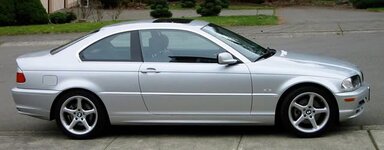

I can't speak for BM Autosport but the rims should be great. Here in the USA, I had RD wheels on my E36 and liked them so well that I moved them to my E46 back in the late 90's into the mid 2000's The product was excellent IMO. I bought mine from Bavarian Autosport (they currently don't deal them anymore) and needed a replacement rim that I bunged up and bought from Racing Dynamics directly. The fitment advice supplied by both the dealer and manufacturer regarding offsets was all correct. I never had any problems with them. Good Luck.
