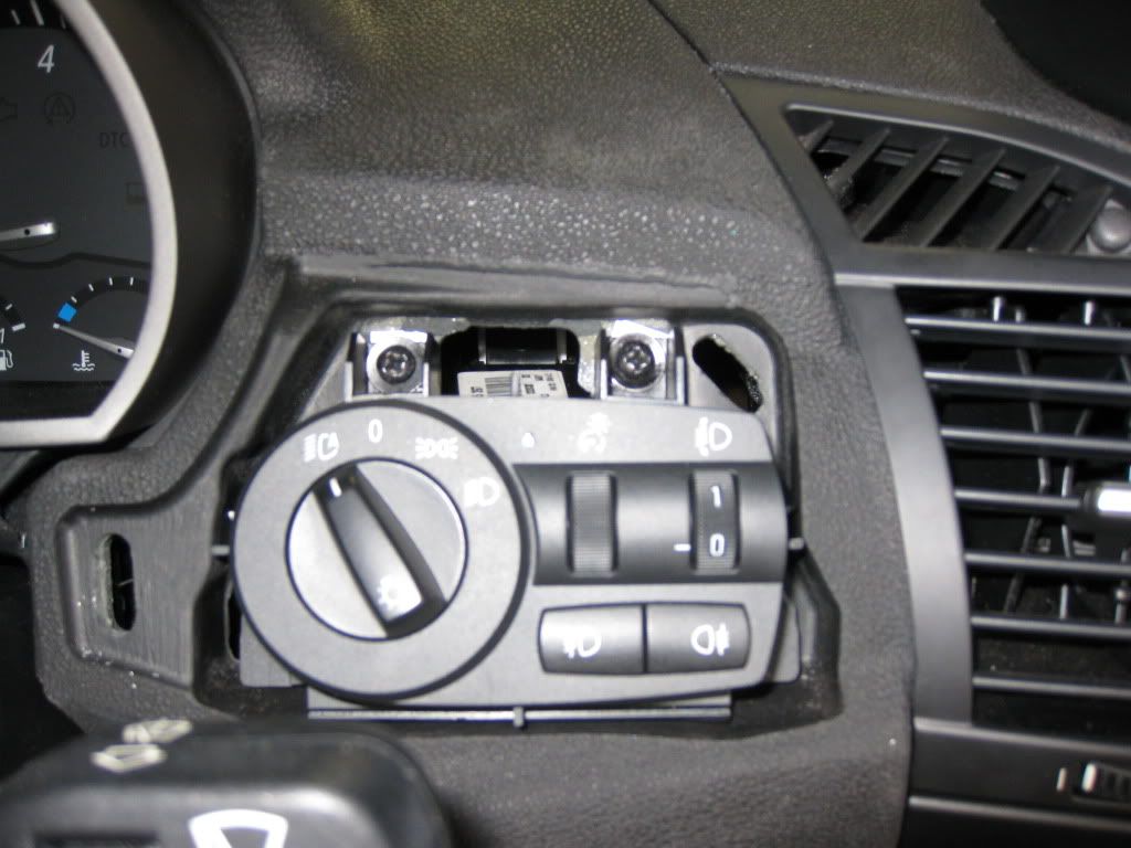

Remove Light switch Surround by using a credit card or something similar that you don’t mind breaking. It does take some force so be patient using two cards is best one either end. Then remove the two screws under the plate.
Remove cable on the top of the switch block, by pulling the white switch handle towards you. That will release the cable, then pull it through you may need to unravel some of the cable tape.

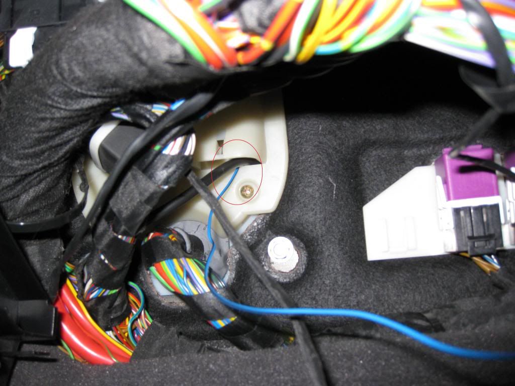

Right now the tricky bit, you now need to feed the blue cable on the Loom (I) behind the stereo down into the passenger foot well and into the engine bay. This took us ages as the BMW Instruction were very poor at this point. To do this you may need to remove the glove box unscrewing 4 screws and then another 2 under the the glove box which releases a plastic cover where the wire will feed into the engine bay.
Once these screws have been removed this is what you should see. The blue cable then feeds through this hole into the electronic box in the engine bay.
