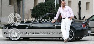

I now own Ac Schnitzer wheels also 19", and I'm planning to get rid off the Ultraleggera HLT which are 19" x 8,5" and were produced in Italy (between last few models produced in Italy)...about year ago they transfer production in China! I've passed just about 3000 km whit them. If you would like to buy them I'll give'm for 1100 Euro!
This is what Zed looks like whit OZ Ultraleggera HLT 19"x8,5" plus pirelli p zero nero 225/35 front & 255/30 rear.

Unfortunately due to Malta's roads which are in a disastrous state, I cannot afford to put 19's on. Although I must say that the Ultraleggera's on that Z4 look amazing.
